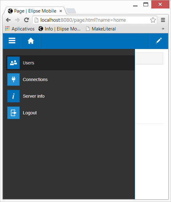

Open the menu and select “Users”.

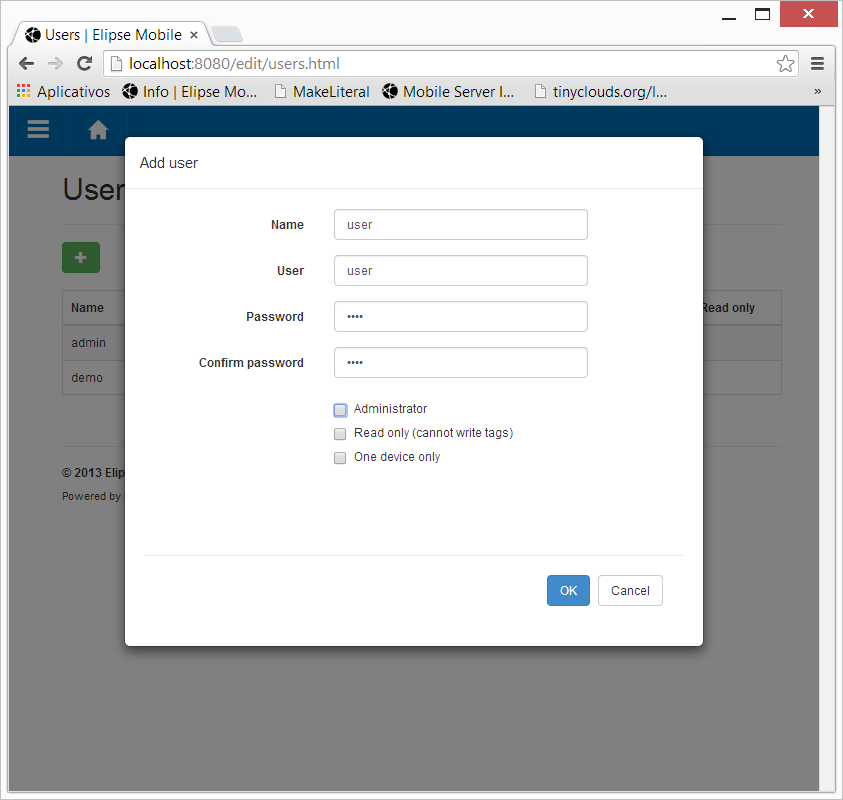

Press the plus “+” button.
Options:
  • Administrator – Indicates that this user can edit applications to create connections and other users screens.
  • Read only – This user is not an administrator and can not send command to tags (write values)
  • One device only – This user is not an administrator and can only connect to the server using one device. For example, an operator who is using his/her personal cell phone.
In this tutorial we will not check any of the above items. It will be a normal user that cannot edit the application.

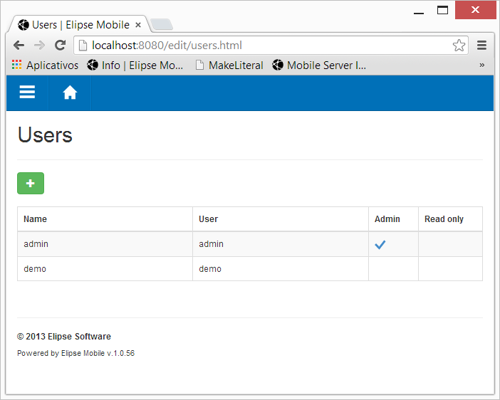

To continue the tutorial you need to log in again as admin/admin user.
